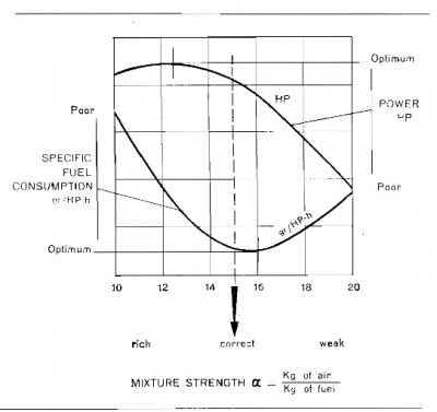

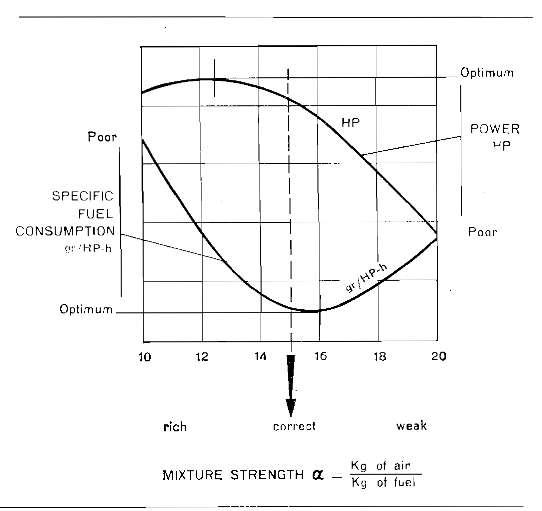

Graf AFR vs poraba vs power:

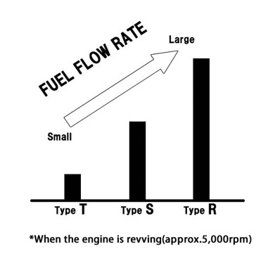

OER emulsion tubes:

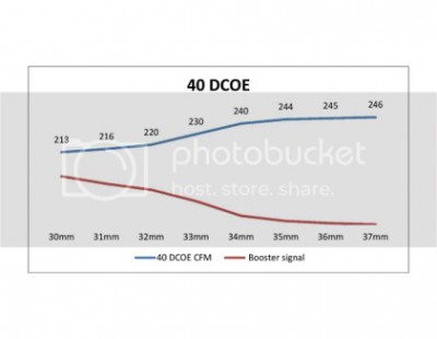

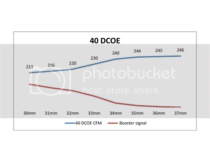

DCOE 40 vs 45 flow / choke size:
DCOE 40 booster signal vs choke size:

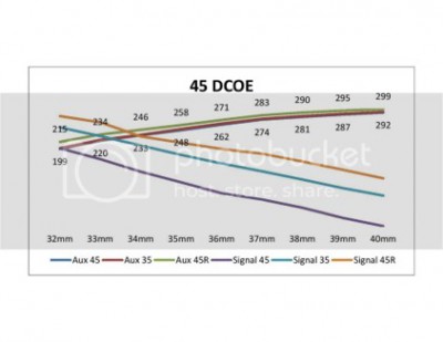

DCOE 45 booster signal vs choke size:
