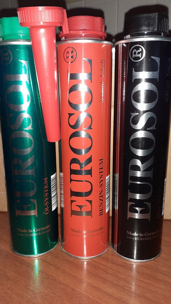

Post by jur76 » 01 Sep 2020, 19:33
Tole bom uporabil.
